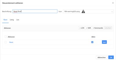

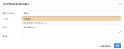

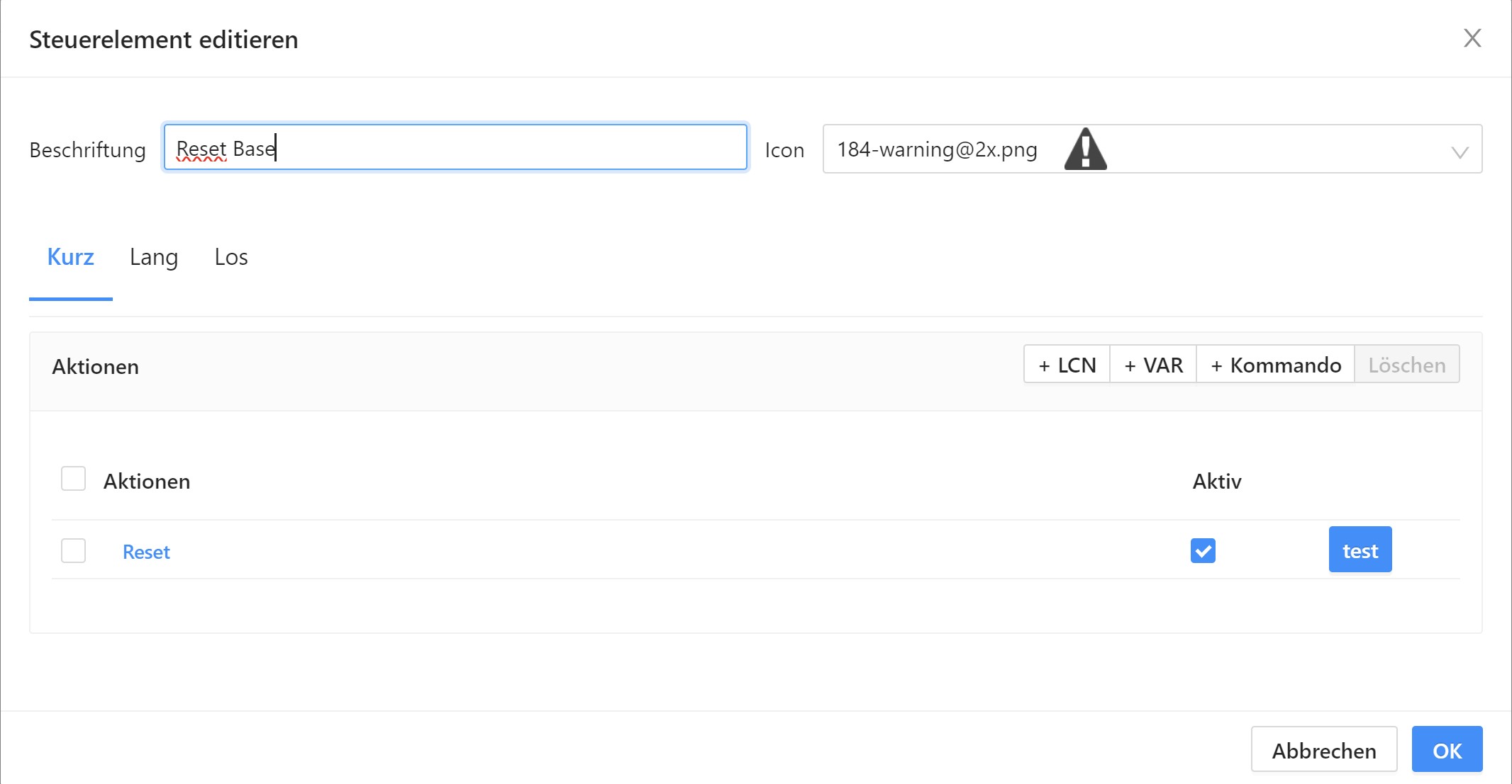

1. Issue: The command C.LOGIC BaseReboot() doesn't work any more since update

Could you provide the rule/command you use for invoking the BaseReboot function in Logic?
Please send it to us over e-mail.

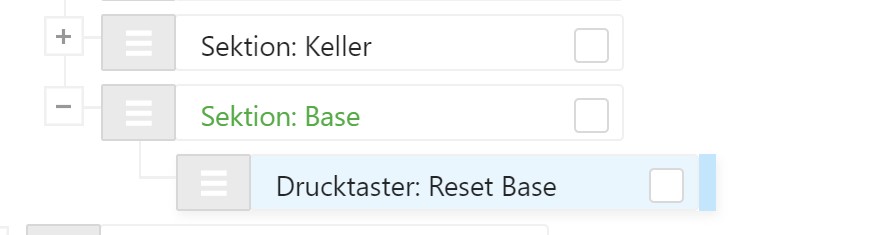

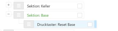

Hello Support,
It's under TAB REMOTE an push button.
Worked until update.
Thx in advance

Could you provide the source code as well?

Hi all,
sorry forgot to add:
function BaseReboot()
command ("C.HTTP.get=http://<user>:<password>@192.xxx.xxx.xxx:<portofbase>/call/reboot")
end
