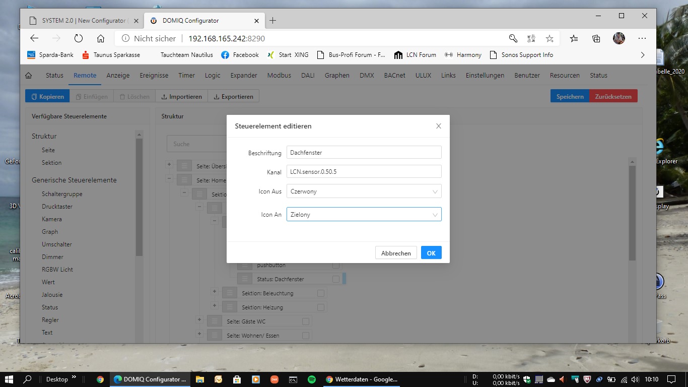

Hello Domiq Team,
great Job thanks.
I discovered one small thing with missing translation. In TAB remote e.g. if you add a STATUS element there are no german translations for the colors or behaviour of the element.
Thx
great Job thanks.
Thx
