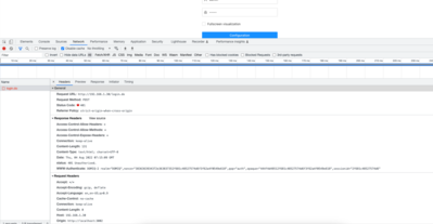

- Here is an example of previewing headers in a login request to Base's configurator.

thank you for the screenshot. But if I call the camera website there is no section like "login.do" or any other section where to find the the mentioned "www.auth string" in the developer console.
Very strange...... I have no idea how to hand over your requested info.
