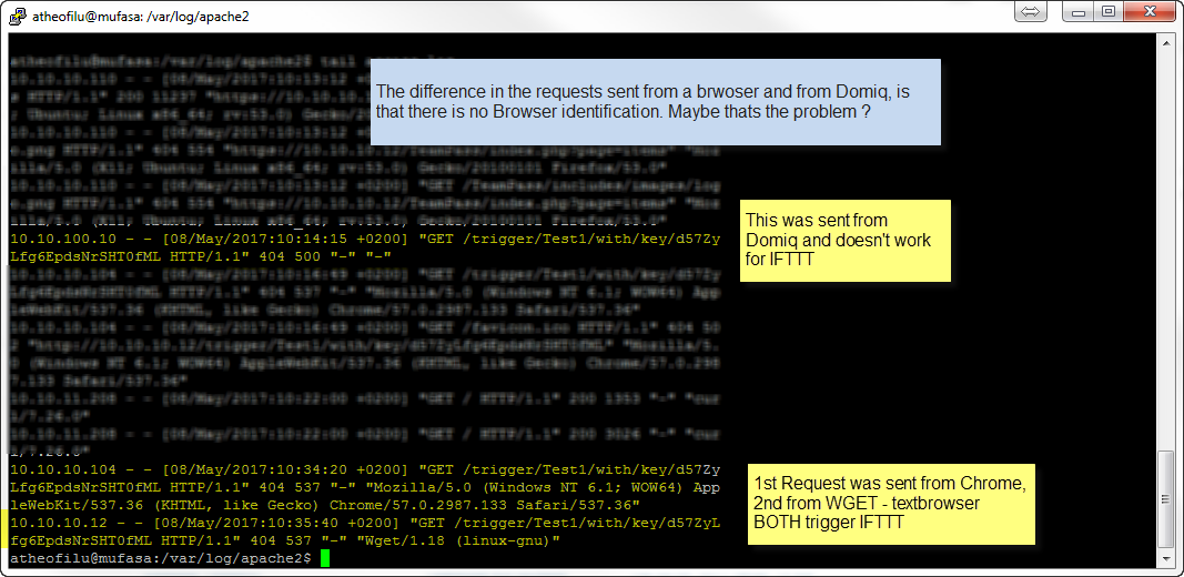

#2 Re: Domiq mit IFTTT
So wie es aussieht schickt Domiq beim Get keine Browser Info mit und dies scheint IFTTT nicht zu mögen... siehe Anhang

#3 Re: Domiq mit IFTTT
Here is the examplary code for IFTTT integration.
In order to trigger and IFTTT webhook just invoke the sendifttt function. Here is the example:
sendifttt("http://maker.ifttt.com/trigger/button/with/key/your_key_here")
Where your_key_here should be replaced with your IFTTT key and the path should match created webhook. This function can be invoked as a result of an event, timer or pressing a button on visualization or from the Remote menu.
Here is the example how to call this function from Remote menu.
1. Add a Pushbutton and double-click on it in order to edit its properties.
2. Click on the Add command option. Then in the Name field enter: C.LOGIC and in the Value field type: sendifttt(here_goes_ifttt_url)
