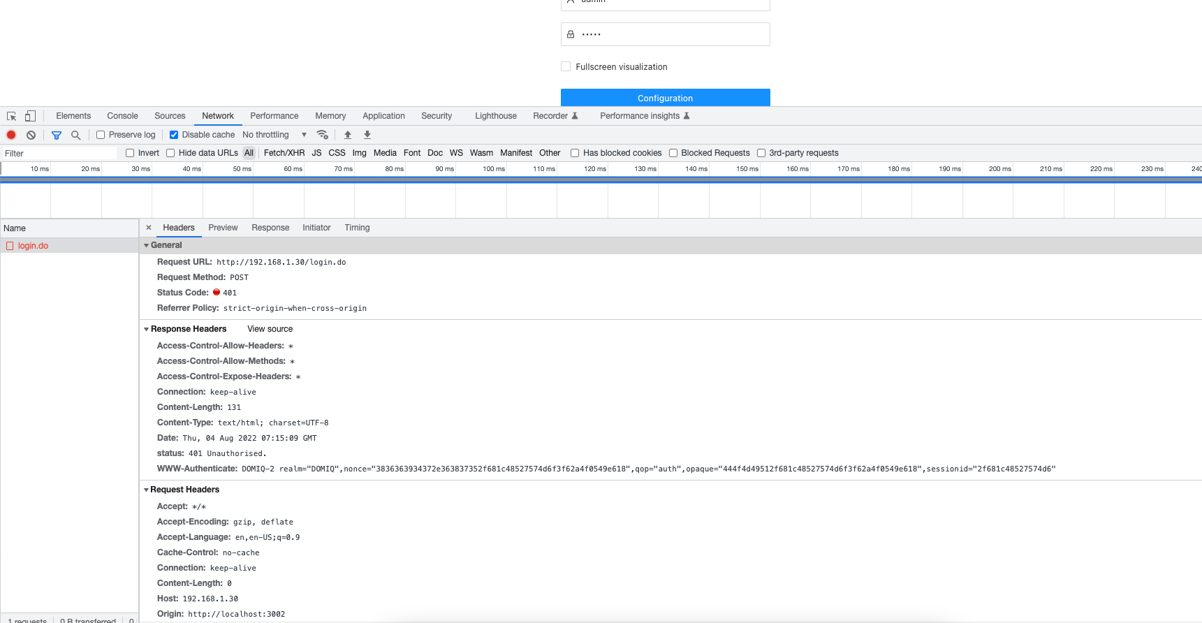

Make a request to fetch stream from camera and during that, keep the Developer Console opened (the Network tab).

DOMIQ-Support
- Beiträge: 292

#10 Re: No IP/ Webcamstream in DOMIQ remote app Android
Hello support,
thank you for the screenshot. But if I call the camera website there is no section like "login.do" or any other section where to find the the mentioned "www.auth string" in the developer console.
Very strange...... I have no idea how to hand over your requested info.
